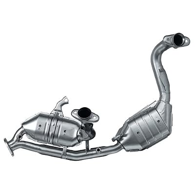

What does the frontmost Catalytic Converter of a 2001 Maxima look like?
I have attached a picture of what I hope it looks like. Please let me know.
Thank you so much
Robin

I have never seen anything that looks like that on a nissan. The front convertor is attached to the exhaust manifold. It is about 12 inches long. The front pipe bolts to the bottom of it with 3 studs and nuts.

This is what the converter looks like (it looks this diagram applies to your car); the front converter would be the elbow-shaped portion labeled "B2 Precat":

The code states I need the bank1 converter, the front converter. I found this picture going through the "store" link on this site. There were several sellers that had it available. Amazon.com was the least expensive, and I trust them. This is what the part is called on this site:
Walker Exhaust 16209 Direct-Fit Catalytic Converter (Non-CARB Compliant)
Walker - 16209, B000VKXAZQ
Walker 16209 Exhaust Product
Any more feedback?

That does look like an aftermarket replacement of the pre-cat that is enclosed by the dashed oval in the picture above your last 2 posts, labeled "front tube assembly". I was under the impression that the front pre-cat was the one closest to the front of the car.
Which code are getting? P0420?

Looks like the one you need is the one in your picture. P0420 is a rear pre-cat related code (Bank 1 pre-cat, the one enclosed by the dashed oval in the diagram I posted). The picture you posted looks like it would replace that whole section that is labeled "Front tube assembly" which contains the pre-cat. However, I don't know if that part actually has a converter in it, unless it is contained within that bulged portion that has a bar code wraped around. The front pre-cat, which sits closer to the front of the car (Bank 2 pre-cat) is related to code P0430.
